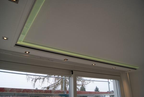

  3. #43 Gast943916, 27.09.2012
    Gast943916
    Gast943916 Gast
